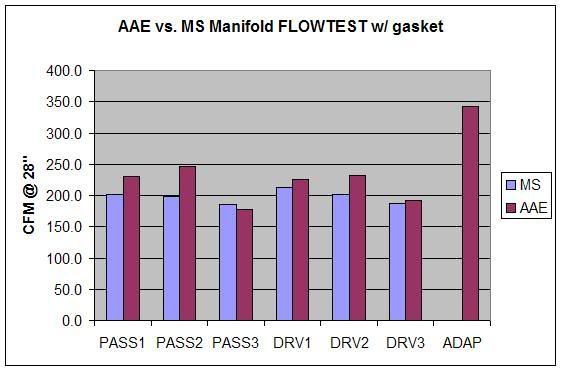

Joe(Nova) for his graph (below) of comparative results.
Several observations:
#1 A "flow test" does not tell the whole story. Example: when flow testing intercoolers....a 6" sewer pipe will "flow" huge, but is a lousy intercooler.
Similarly, on an exhaust manifold, a sample of one exhaust port may flow well individually, yet may fall short under dynamic conditions....reconizing that a "log" style manifold has to share the load of three series-connected exhaust ports. Despite the apparent "fact" that only one combustion pulse occurs at a time, unequal primary runner lengths and normal backpressure of a turbine naturally causes these pulses to "collect" prior to entering the turbine valute. I purposely made runner #2 larger to flow the exhaust of cylinders #1 AND #2 as well as a HUGE collector.

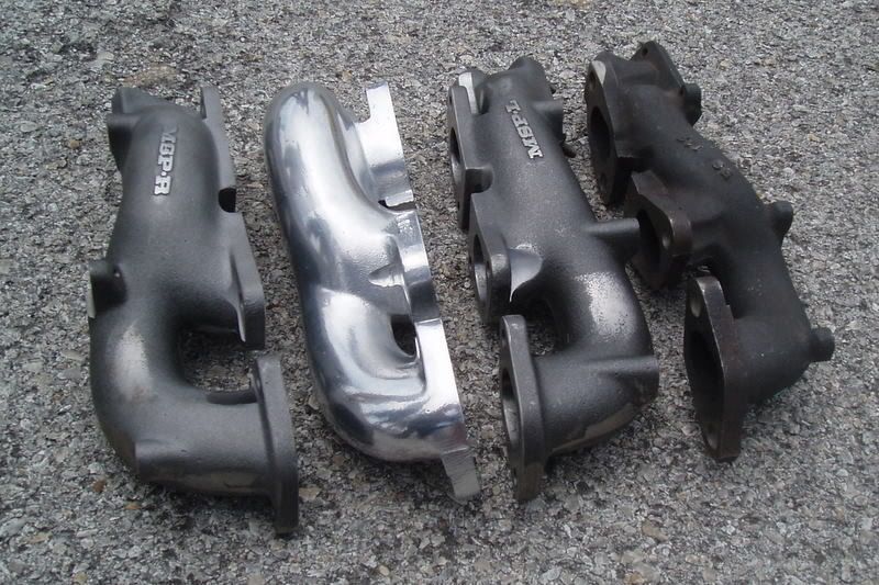

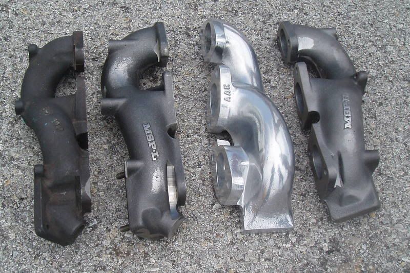

These pics (from ZCON 2006) show that the AAE manifold has a definite advantage here.....which cannot be demonstrated in the test methodology used.
#2 There is also a large difference in the port sizes between the two manifolds. Ash, being the "purist" he is, wanted to only test the manifold(s), not manifolds AND the cylinder heads as has traditionally been done.
Unfortunately, the larger port dimension would not represent the actual application. To be a more representative test, Ash used a standard gasket to simulate the manifold/head assembly.

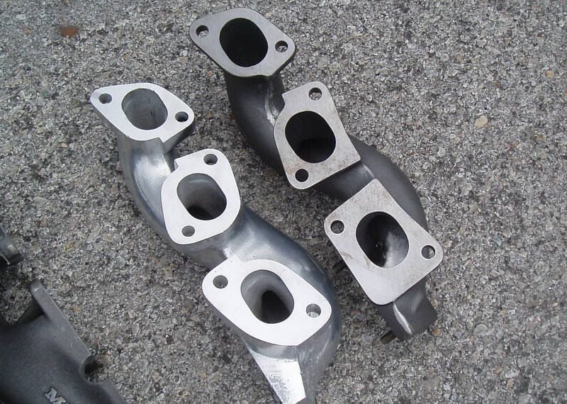

The AAE manifolds are gasket-matched, precisely machined 1/8" larger than the exhaust port(s). Despite good intentions, the abrupt transition of the larger MS ports may actually increase turbulence.
One could argue as Ash has that the true potential of the MS manifolds will not be realized w/o enlarging the ports to match. However,the extreme porting required may result in an encroachment on the coolant passages.
This is apparent in the photo below:
